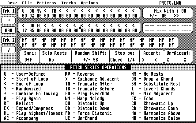

All of the above could be applied to a pattern that you create. You can have 96 patterns in memory at a time. You can also have preset rhythms that you can create and apply similear transformations. Facinating results can be obtained. The only condition however, is to build up a library of patterns and rhythms to work with initially so you have starting points, or "bones" as Ludwig calles it. You build a composition by inserting "instruction" or 'operations' within 'cells'. You can have a total of 1024 cells, which gives a tremendous amount of room to string your patterns and permutations of the patterns together.
You can also imagine it as an 8 track analog style sequencer. Each track can be assigned a midi channel as well as patch changes. It can also be muted even while it is playing. You can assign whatever patterns you have created and then permutate those patterns with the algorithms. You can do this for Pitch, Velocity and Rhythm. What a system!

10. Looking at Track 1, you will see in the first cell a [U] with a [00] below it.[U] stands for USER PATTERN while [00] stands for pattern number 00 in the pitch pattern list we just veiwed. Click into the U/00 cell so it is highlighed.Right-Click on[00] and the number increases. Left-clicking will decrease it.Change it to [01] This means we have changed our user pattern to number 01 in the pitch patterns list. Get it? Now click anywhere outside the field in the screen and it un-highlights.
11. Press the space bar. You will hear a different pattern playing then when we first started .Now the FUN begins ! Click into the second cell ON the letters EC. A dialog appears at the bottom of the screen for PITCH SERIES OPERATIONS. These are the actual algorithms that you can create variations to the initial seed pattern. For our purposes, click into RF (Reflect) RF goes into the cell, but it is still highlighted.You can now put in a value for how much 'reflection' you want by right clicking into the number cell under RF. Change it to [05]. Now click outside the feild to enter the parameter, and the cell un-highlights. You will now hear a change in the pattern as the algorithm RF permutates it. Now you can start having more FUN as you click into the next adjoining cells, select different pitch series operations and values and hearing what it does to the initial 'bone'. Facinating variations can be created from one initial seed pattern or BONE.

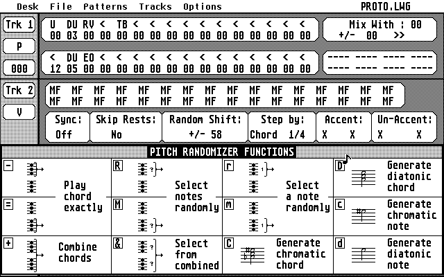

14. Now for something completly different.On the right side of the track dialog is a section that says MIX WITH [00]. Right-Clicking into <00>will allow you to enter a value. Change it to [05]. This means that Pattern 01(the initial seed pattern) will be mixed with pattern 05. Below this is a dialog for +/- [00]. Clicking into this will allow you to put in a 'percentage' of how much pattern 05 will be mixed with pattern 01. For our purposes, change it to +/- [30].
15.Now left-click into an empty slot below the percentage dialog and another impressive dialog presents itself: the PITCH RANDOMIZER FUNCTIONS. There are many options for random permutation. For our purposes, select R :[select notes randomly]. The R goes into the slot. You can select more slots to put in more random functions.However we don't hear the permutations yet.(remember...the music is still playing!) How come? We have to tell a Ludwig where we want the random permuations. We do this by selecting another empty cell in track 1 and selecting [?] RANDOMIZED. Now the features we just programmed will take place when Ludwig arrows to the [?] cell.

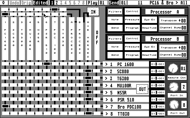

Main GenEdit screen with Cool Studio
GenEdit ST v2.02 NEW VERSION !
By Tom Bajoras
Hybrid Arts
Released ver1.1 as Freeware May,2000
Ver 2.2 released Nov.2003 I am now happy to announce the availablity of a new version of GenEdit. Thanks is due to the long persuance of Joe Hlifka (of Albuquerque, New Mexico) and his team. (see below)
What is GenEdit?
GenEdit St is a "Universal Midi Organizer-Editor-Controller". Instead of using a seperate editor for each synth, GenEdit allowed many synths to be edited in one enviornment.Also, if there was no editor available for your particular synth, you can create a 'template' for it .GenEdit runs on Atari ST, Mega ST, STe, Mega STe, TT and Falcon computers in ST Med and ST High resolutions (GenEdit does not run on the ST 520 because of memory limitations)

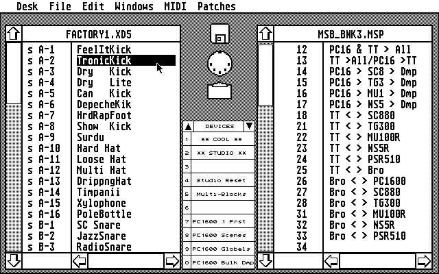

Kawai XD5 editor

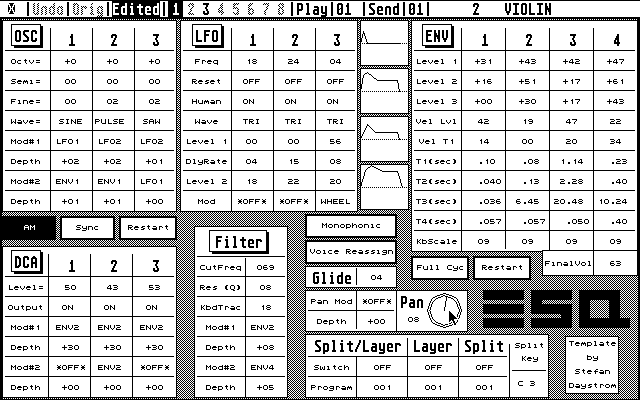

Ensoniq ESQ editor
The GenEdit Tutorial and Manual
A tutorial in ASCII text format is included with GenEdit v2.02. It represents about 35-40% of the GenEdit Version 2 manual. Hopefully it provides enough on the basics to get you started, if you are new to the program. A complete version 2 manual will be available some time in 2004. The manual will include Chapters 8 and 9 and Appendix C containing GenEdit's native CNX language needed to write your own custom configurations. The manual will also include all screen shots from the original v2 manual. The GenEdit v2.02 Freeware Version manual will be made available in PDF format on a GEnEdit v2.02 CD ROM (still in development).

"Cool Studio" - A Sample GenEdit Studio Setup
If you are new to GenEdit or have only used GenEdit v1.0, you may find it helpful to download the archive COOL_STU.ZIP. This archive and the EXAMPLES archive, contain all the necesary files for a fully functional demo "Studio Setup" for GenEdit. "Cool Studio" is a Plug 'n Play multi-instrument MIDI studio under the control of GenEdit.
"Cool Studio" includes support for the following gear:
EMU ...... Proteus Fx / Classic Keys - editor
Kawai .... XD5 - editor
Ensoniq .. SQ-80 & ESQ-M - editors
JLC ...... MSB+ Rev2 - dump utility and editor
Korg ..... NS5R / NX5R - dump utilities
Gensysex . Universal (MIDI-EX) dump utility used with SysXpress
Peavey ... PC1600x MIDI controller - dump utilities
Roland ... SC880 - dump utilties
Yamaha ... DX7 - editor
Yamaha ... TG100 - dump utility
Yamaha ... TG300 - dump utilities
Yamaha ... MU100R / MU90R - dump utilities
Yamaha ... PSR-410. 510, 1700 and 2700 keyboards - dump utilities
(Note: see the download section for a text file on all the supported instruments for GenEdit)
