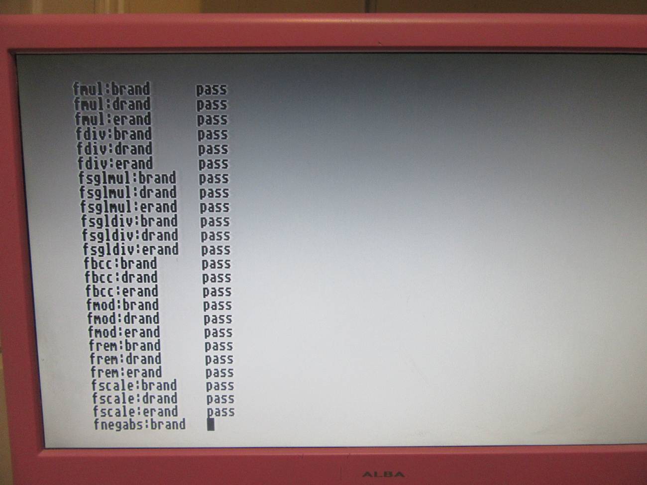

TEST 1 - FPU TEST
Each function within the FPU undergoes several hours of rigorous testing, during which it is assigned a suitable speed grade of 16MHz, 40MHz, or 50MHz. When testing CPUs, they are consistently operated at the maximum speed of 50MHz. This ensures that the CPU is subjected to the highest and most prolonged clock speed achievable during FPU tests, causing it to inherently reach its peak temperature. If the tests reveal any failures, it indicates that the CPU is incapable of sustaining the 50MHz speed. In such instances, we adjust the speed to 40MHz and conduct the tests again.

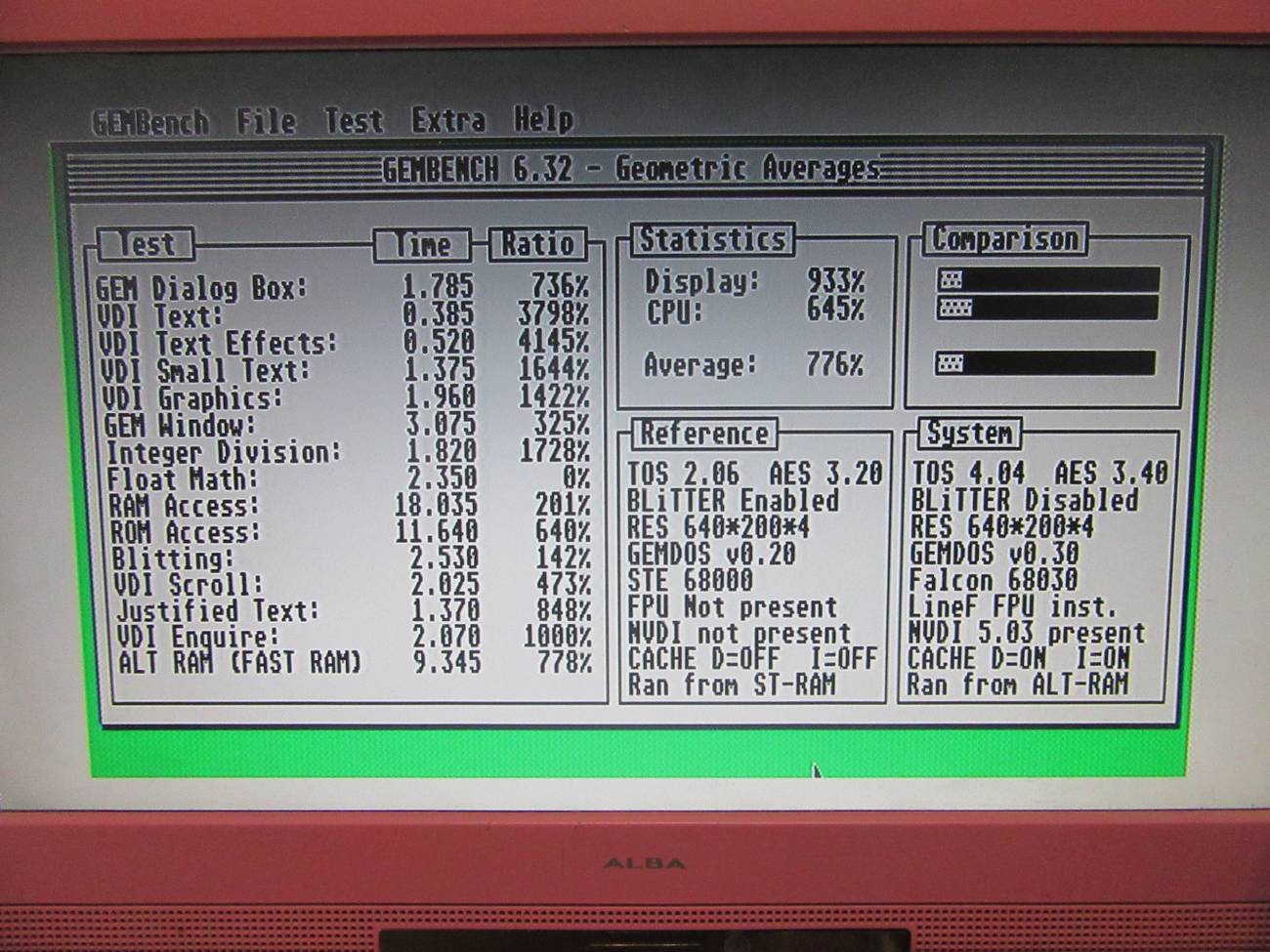

TEST 2 - GB6 BENCHMARKING
Benchmarking stress tests thoroughly assess various components of the system, with a particular focus on the CPU. These tests are conducted over several hours to not only evaluate the overall system performance but also to confirm the CPU's capability to operate at specified speeds. This extended testing duration ensures a comprehensive examination of the CPU's stability and reliability under sustained stress, providing valuable insights into its performance characteristics.

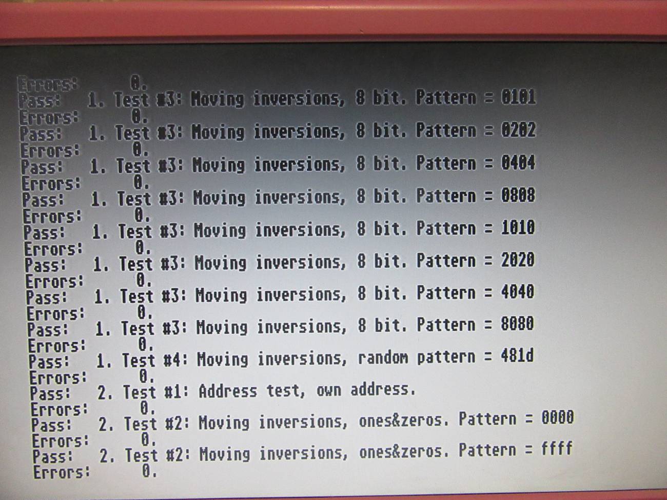

TEST 3 - RAM TEST
We conduct extensive memory tests that serve a dual purpose: not only do they comprehensively examine the system's memory, but they also act as stress tests for the CPU, assessing its reliability under prolonged and demanding conditions. These tests involve in-depth evaluations of the memory subsystem, pushing the CPU to its limits to ensure that it can consistently and dependably handle the demands placed on it. The extended duration of these tests enhances the thoroughness of our examination, reinforcing the reliability and robustness of both the memory and the CPU within the system.

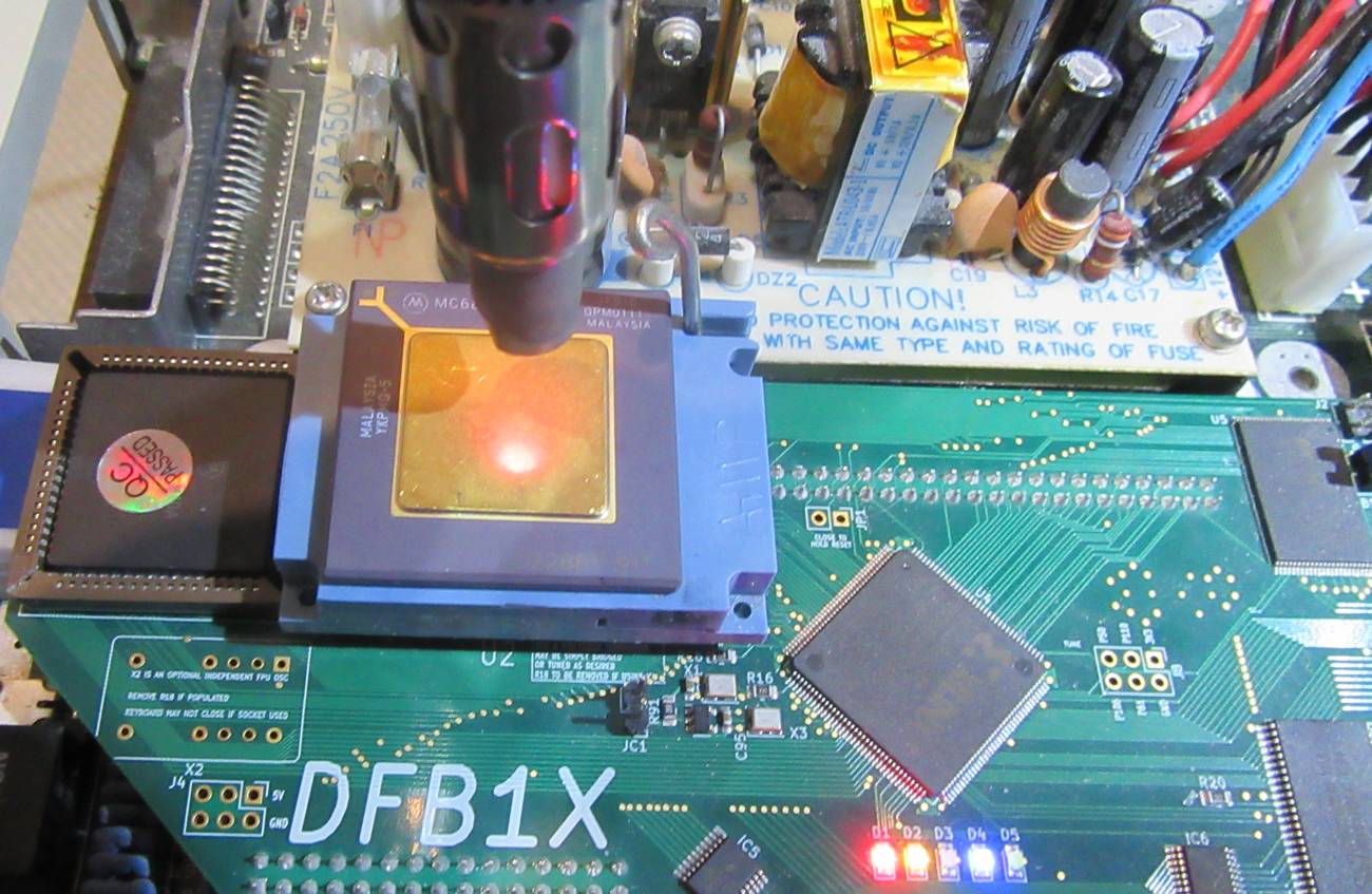

TEST 4 - THERMAL TEST
Even after successfully passing the aforementioned tests, we take an additional step to artificially raise the CPU's temperature beyond normal working conditions. This process verifies the stability of the CPU even when subjected to higher-than-usual temperatures. Some CPUs may function without issues for a few hours before encountering thermal problems. Apart from the prolonged testing, our deliberate heating of the CPU ensures its reliability under the most extreme operational temperatures. This is a practice that sets us apart, as many suppliers neglect such comprehensive testing procedures.

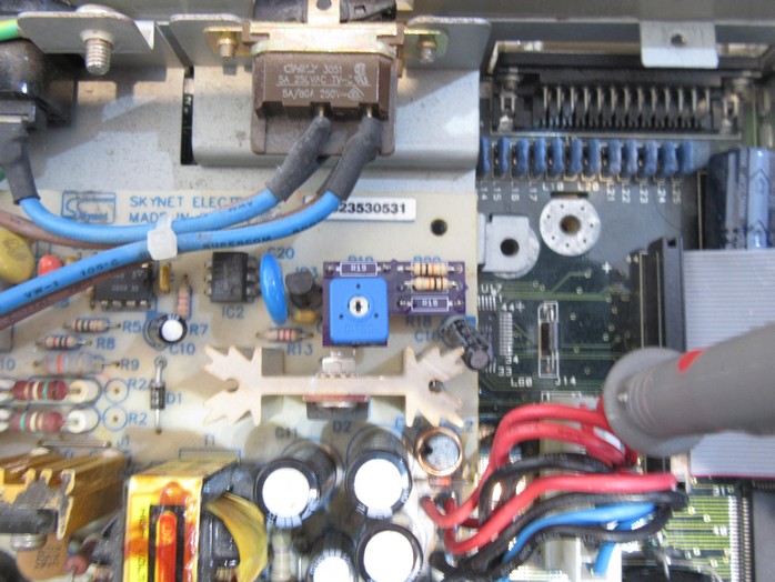

TEST 5 - VOLTAGE TEST
In addition to the mentioned procedures, we go a step further by running the CPU at 5.3 volts to confirm its sustainability under higher voltage conditions. This not only aids in elevating the internal temperature of the CPU beyond the norm at 5 volts but also ensures its stability at increased voltage levels. This meticulous testing approach, including both elevated temperature and voltage assessments, reinforces our commitment to guaranteeing the reliability of the CPU under a diverse range of operating conditions. Such comprehensive testing practices set us apart from suppliers who often overlook these critical aspects. The voltage test is done with a Falcon voltage adjustment board as shown in the above image. It is important to emphasize that we strongly advise against running these CPUs without a heatsink. Installing a heatsink and fan is highly recommended, as it significantly extends the processor's lifespan and should be regarded as a standard practice to ensure effective cooling measures. |
